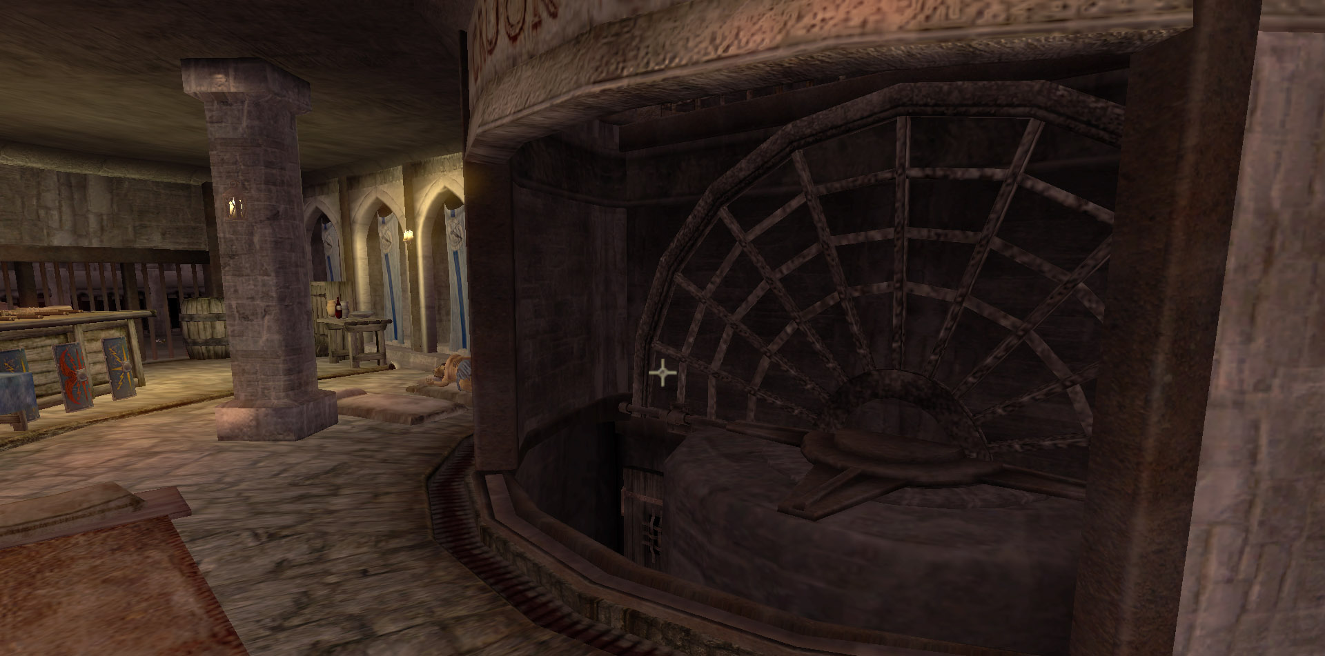

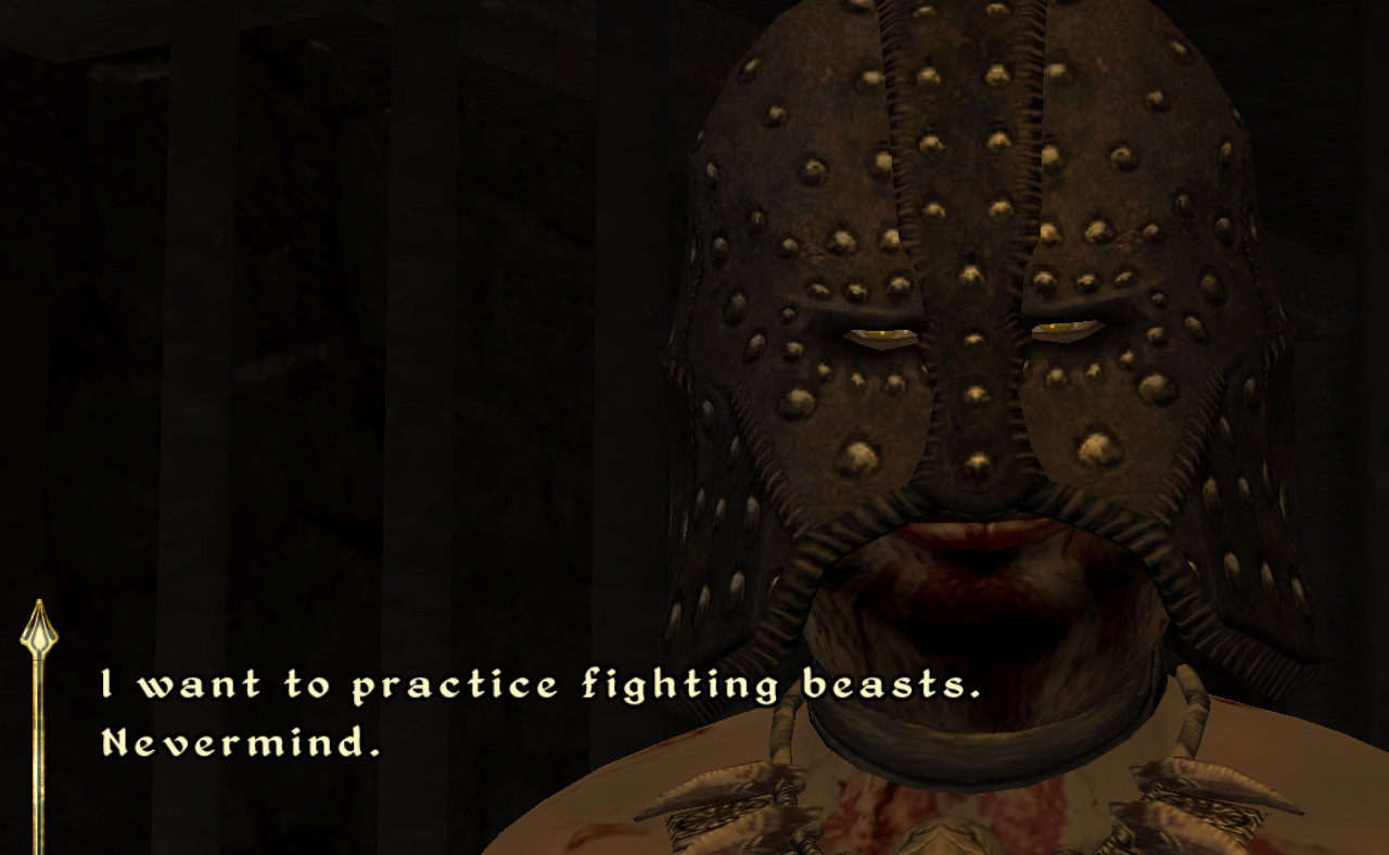

note: To be able to train with the Beastmaster and see creatures in the BloodPit cages, you need to be an Arena Combatant already. The Beastmaster of the Arena can be found in-game in the BloodPit under the Blue Team BloodWorks, The Bloodpit entrance is a new door that is the bars in the center column. If you lift themetal plate it will reveal a semi-circular stairway. Like this:
The BloodPit is meant to be more...but at this time you can pay the Beastmaster to fight random beasts in the cages. Choose your cage number, and pay the fee, the Beastmaster will then leave to close the middle-ring and open the cage you chose via a lever. Don't follow him outside the middle-ring before he close it or you will be trapped with no way out.
If not in combat and the Beastmaster is roaming around, you can go upstairs and find the Room VII on the Blue side. It's yours with a bed and a chest, you get the key from Owyn once you join the Blue. Flavius upstairs in the Blue Team Bloodworks will later sell you some furnitures should you need some for you room.
If you empty the 10 cages in the BloodPit, you will win some gold. Each time you empty ten cages up to a certain maximum that is very high, you gain in some attribute (1 point), and more and more gold depending on how many ten cages you kill. The sum of your BloodPit kills is counted in a book you can find upstairs. Once you empty a cage it will remain empty and filled anew only if you empty all ten and leave the BloodPit a while.

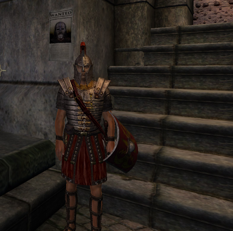

ztrathego wrote:There's an issue that show up with WAC - Legion.esp active
Why am I not seeing this armor in any of your screens? Your 'best' one is not wearing sandals! :P Does everybody have the problem ztrathego have? Maybe it's something in your data folder? The legions have been changed a lot so far by many people, and in WAC you can chose between 2 different changes... not sure here. I made this mod on a whim... really.
Edit: I went to the arena to see if if there were any issues after these changes, but it all seemed fine. Also, I'm trying to determine what bash tags might be useful to add to the various esp's, and have so far noticed that WAC - Horses.esp could use the Graphics tag to make the bashed patch import all the new models. That along with the changes I posted for WAC - Legion.esp before is all I've come up with so far, but I'm not very good at this stuff so I'm sure someone must've figured out more than me so far.

Is it normal that I can't fight against the Grandmaster?
Because I can't go in the Arena after the dialog with the woman from the Blood Team.

Bizzy wrote:Is it normal that I can't fight against the Grandmaster?
Sorry for my English :) .
Yes it is normal. The BloodTeam BloodWork is nearly complete, but the main quest will not work correctly at that point as I changed Agronak look and location. I need to make a bridge between the old quest and what I want for it.
That's what I meant when I wrote in the read-me that you may not be able to complete the Arena quest for now. Although after speaking with her you should be able to return to the Blue Team side and enter the Arena from there maybe?
Otherwise, you seems to have made in the Arena up till the Grand Champion, so I guess the Arena Quest was working fine up to that point which is good enough for me at the moment...
ztrathego wrote:@Waalx: Thanks for looking into what we have reported thus far. :)
That sandal issue is weird! I'm looking at the WAC - Legion.esp now, and there is no reference to sandals (or boots of any kind) in it.
About the eye-mesh issue with beastmaster, I believe it only becomes an issue when used together with certain mods that make changes to the races such as Race Balancing Project and TRAP.
The sandals are not a separate object, they are part of the suit of armor. The Legion.esp armors are full suit of armors, so technically they should replace everything an Imperial Guard is wearing. Helmets are separate, the rest make use of all body slots.

Ah so the cuirass actually includes the sandals and skirt aswell, that changes things! Got it work just fine now after simply adding Graphics and Invent tags to the original esp instead of making the changes with tes4edit I posted earlier. Some guards still seem to use different helms though but I suppose that is intended (ie, not the plumed helm - the guards on the Weye bridge for example). Cheers for clearing that up, the sandals fit alot better. :)
